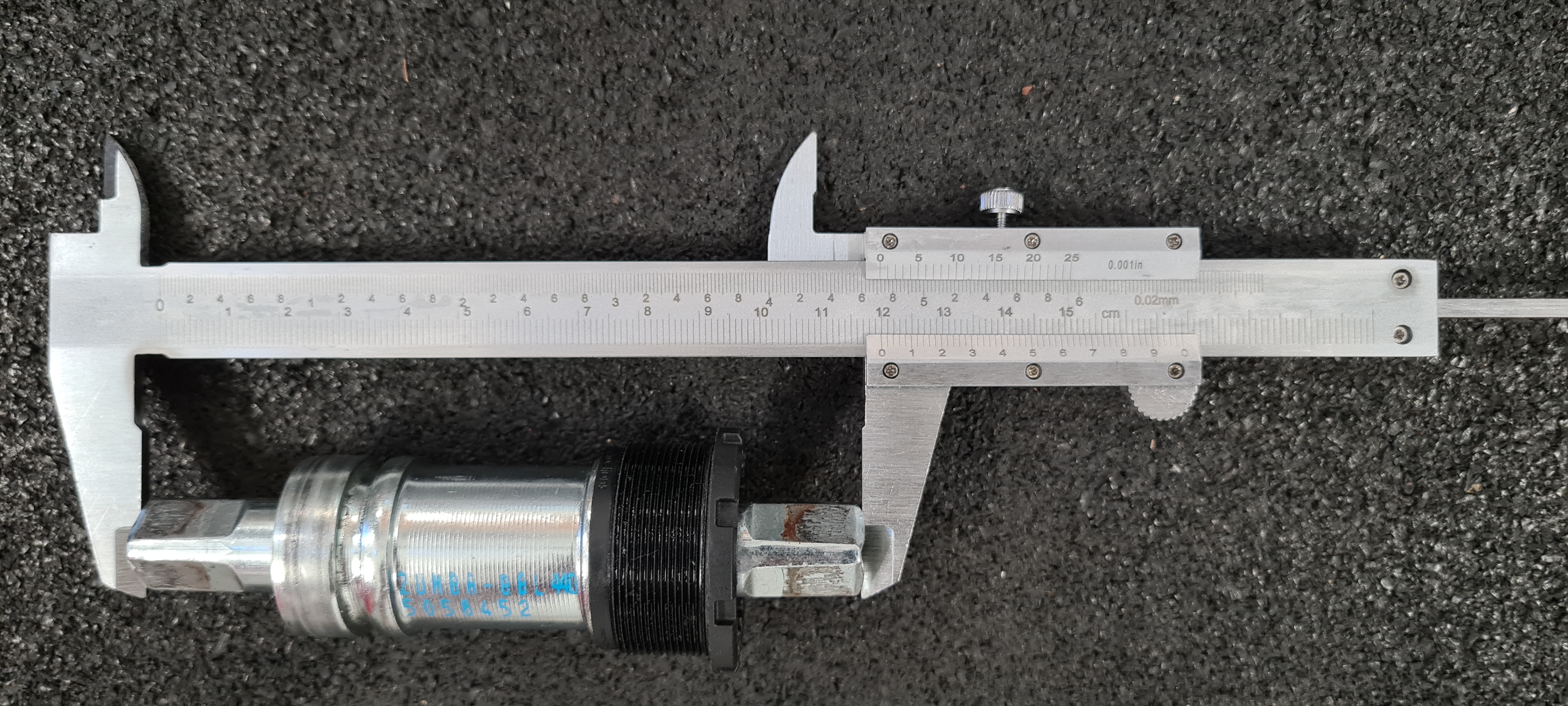

    Hi,
    Hi,
    thanks for the advice, it is exactly 120mm so I guess the 119 would be best option
    https://cdn.road.cc/wp-content/uploads/roadcc/20220711_202835.jpg
    #994519
    Secret_squirrel
    Double check the spindle
    Double check the spindle length with calipers, and also confirm its symettrical in the frame.
    There is a lot more choice at 119mm and you can usually offset it in the shell to get the extra 1mm if needed, if you choose a BB with a flangeless non-drive side cup.  1mm of Q factor wont make any difference and clearance will probably be unaffected.
    Royce, Phil Wood and Stronglight do a 119mm JIS that should work and the more expensive ones will have massive warantees on them.
    royceuk.co.uk
    Otherwise have a post on Retrobike.co.uk and get a quality used or new old stock one.  There’ll be some one with a hundred of them in their shed.
    Looks like  Campy did 120mm JIS bb’s at some point too.
