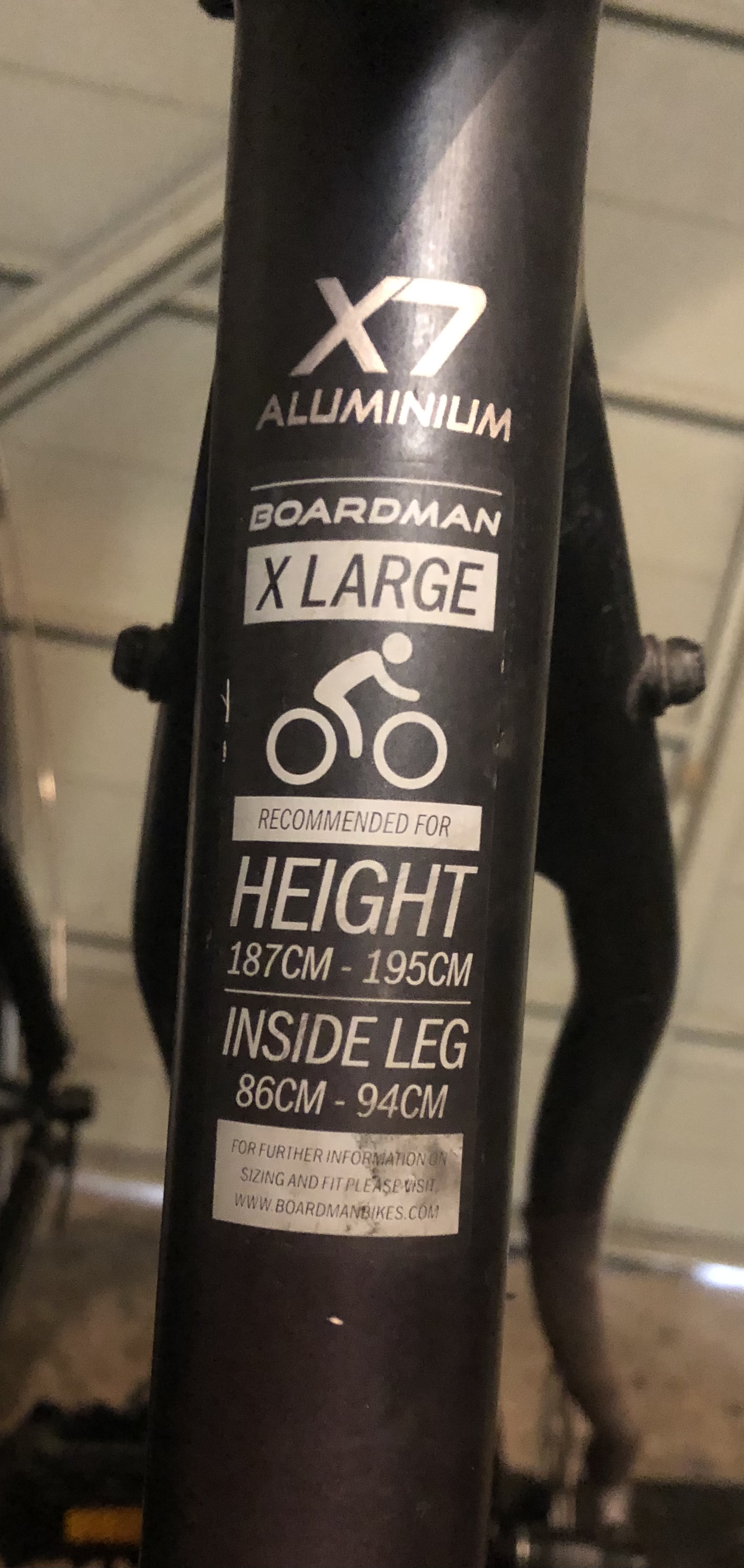

    I’m about 183cm and ride a
    I’m about 183cm and ride a Large ADV which seems right to me

    This pictures goes with my
    This pictures goes with my reply which may be pending?  In brief, at 188cm height I could go L or XL, went XL and am happy with that choice.

    alan sherman
    How do you find the sizing?
    How do you find the sizing?  The guide suggests a large, I think a medium might fit me better (I’m 184cm).  I really need to sit on one when there is one in a shop.
