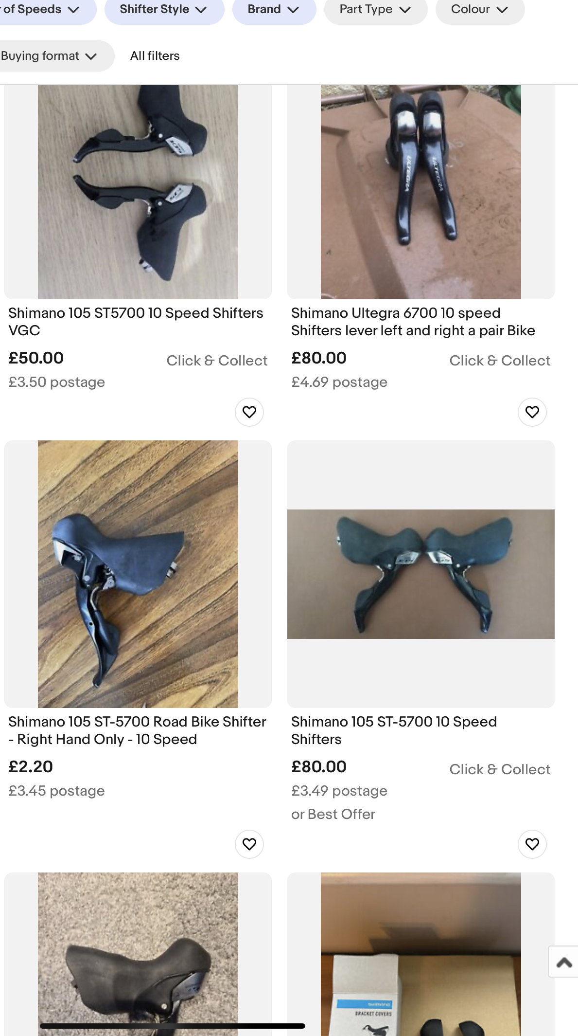

    #1015545
    Some options on Ebay now.
    https://cdn.road.cc/wp-content/uploads/roadcc/IMG_4812.jpeg
