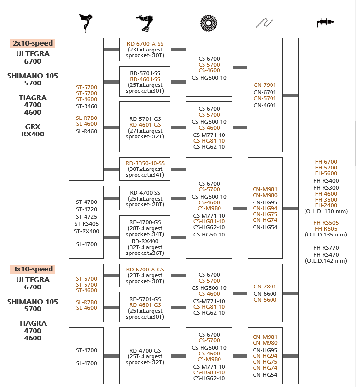

The right STI shifter on my 10-speed Ultegra bike broke. Not 100% sure, but I think 6700. I’m looking for a suitable replacement. There doesn’t appear to be any 10-speed 105 or Ultegra available anymore on retailers I’ve looked at.
I want a replacement that has the same shifting action as the Ultegra, preferably also with the same Ultegra rear-along-bar cable routing (not the “stick out the side” routing). I.e., I don’t want thumb levers. The only 10-speed available seems to be Tiagra 47xx and Tiagra 4600. If I understand correctly, the 47xx 10-speed is not compatible with 6700. While the 4600 has the side-sticky-out cable routing.
Is there any good replacement for a 6700 shifter, that doesn’t result in a weird franken-bike, or involve upgrading most of the groupset?
Note: I would replace both shifters if necessary. So any decent 10-speed shifters compatible with 6700-era RDs/FDs I’d love to hear about.
