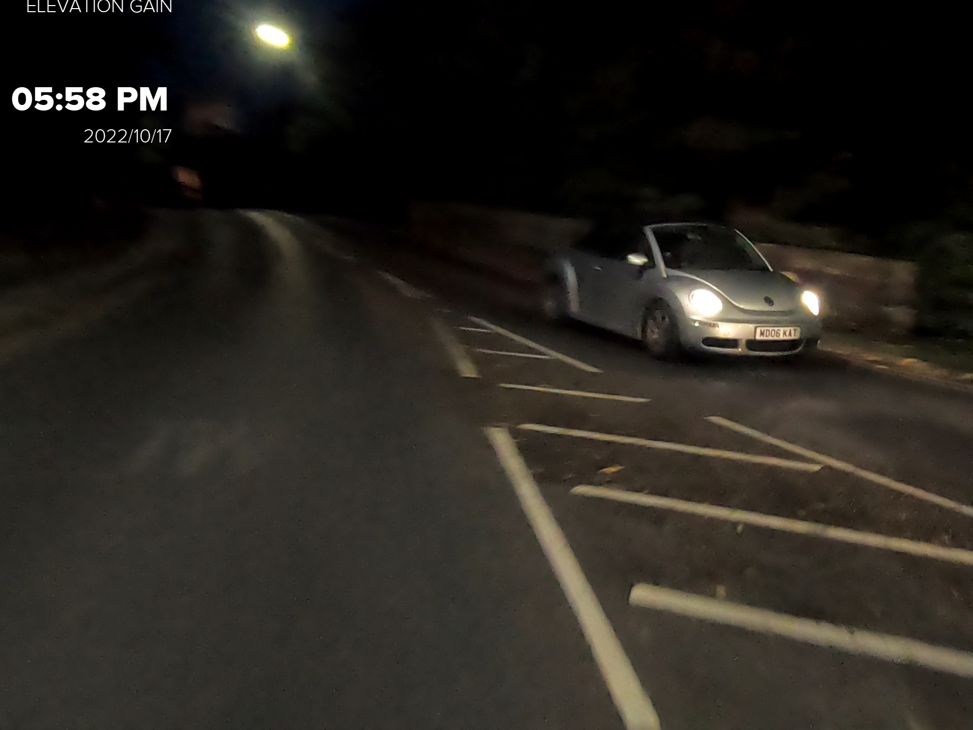

    And this is night plate
    And this is night plate capture, accomplished with Aldi front light on constant setting 2 out of 4, angled right. You don’t get them all! (no fault committed by this driver)
    https://cdn.road.cc/wp-content/uploads/roadcc/NightPlateCapture-16Oct22.jpg

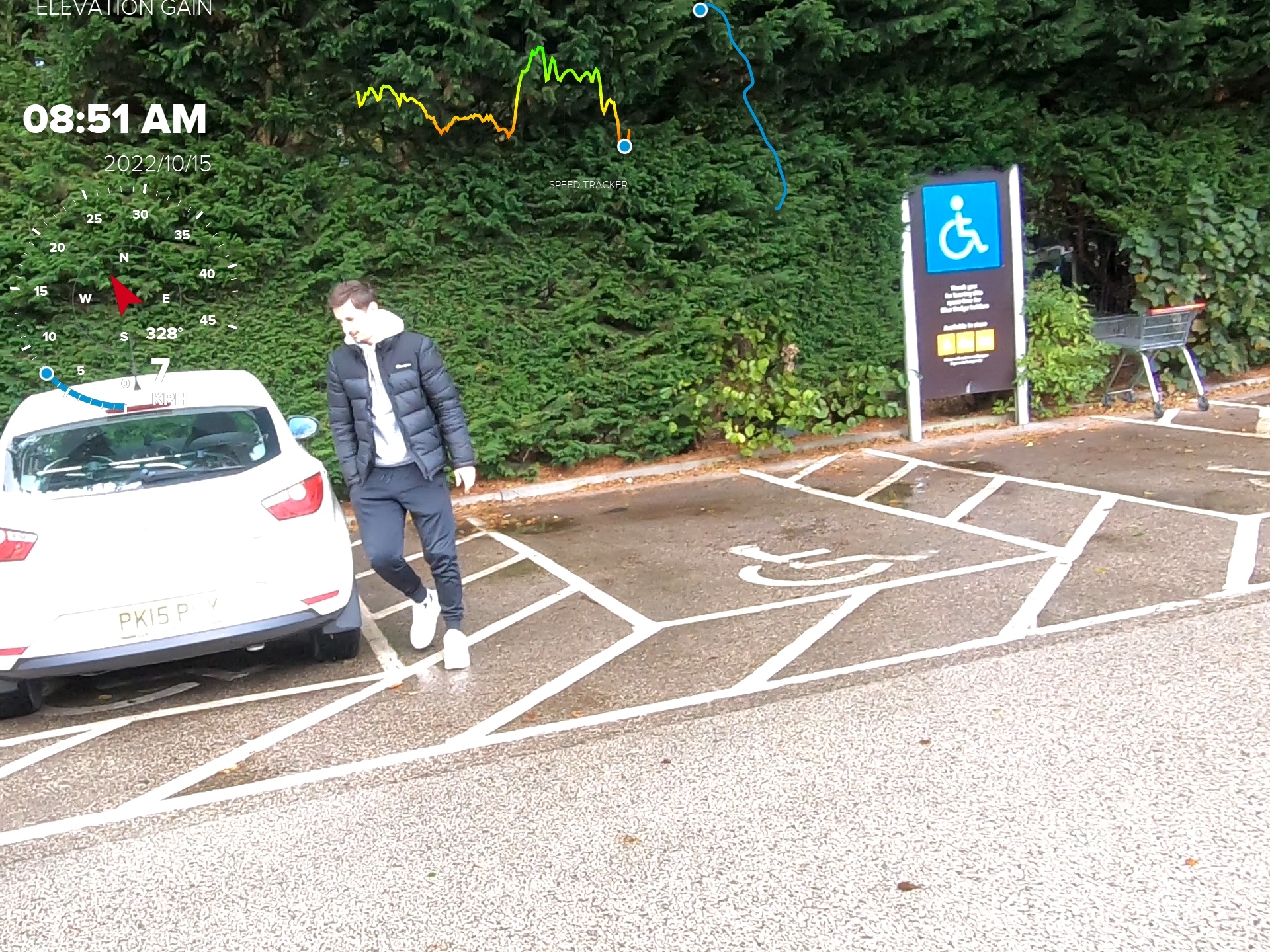

    And this is the driver at
    And this is the driver at Sainsbury’s cash machine, showing a common feature of combining GoPro and the ubiquitous white car beloved of offenders. However, you generally can get a frame or two with legible plate straight out of the camera, and it’s easy to correct any individual image in Windows anyway. Mostly, all plates are detected even on the other side of the road

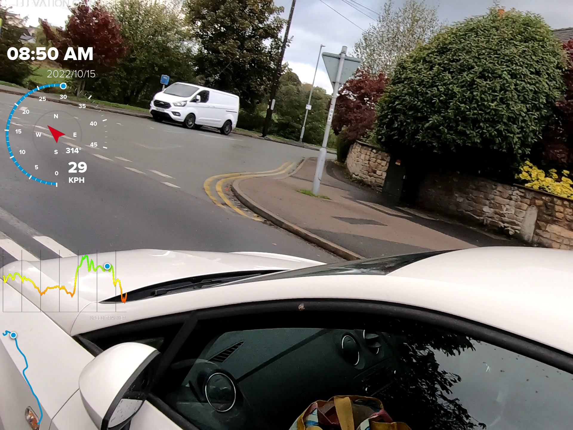

    Problem with GoPro is the PC
    Problem with GoPro is the PC software which is really unpredictable and you can’t get it to load until another day- this is because it hasn’t been supported for years. The phone app is no substitute. None but the Hero7 Black have GPS, which is essential for me, but nobody seems to be mentioning this feature. My guess is that none of these other common cameras have GPS. This is white Seat Ibiza PK15 PCY performing really close passing and illegal crossing of double white lines at the same time
    https://cdn.road.cc/wp-content/uploads/roadcc/ClosePassSeat-15Oct22-0001.jpg

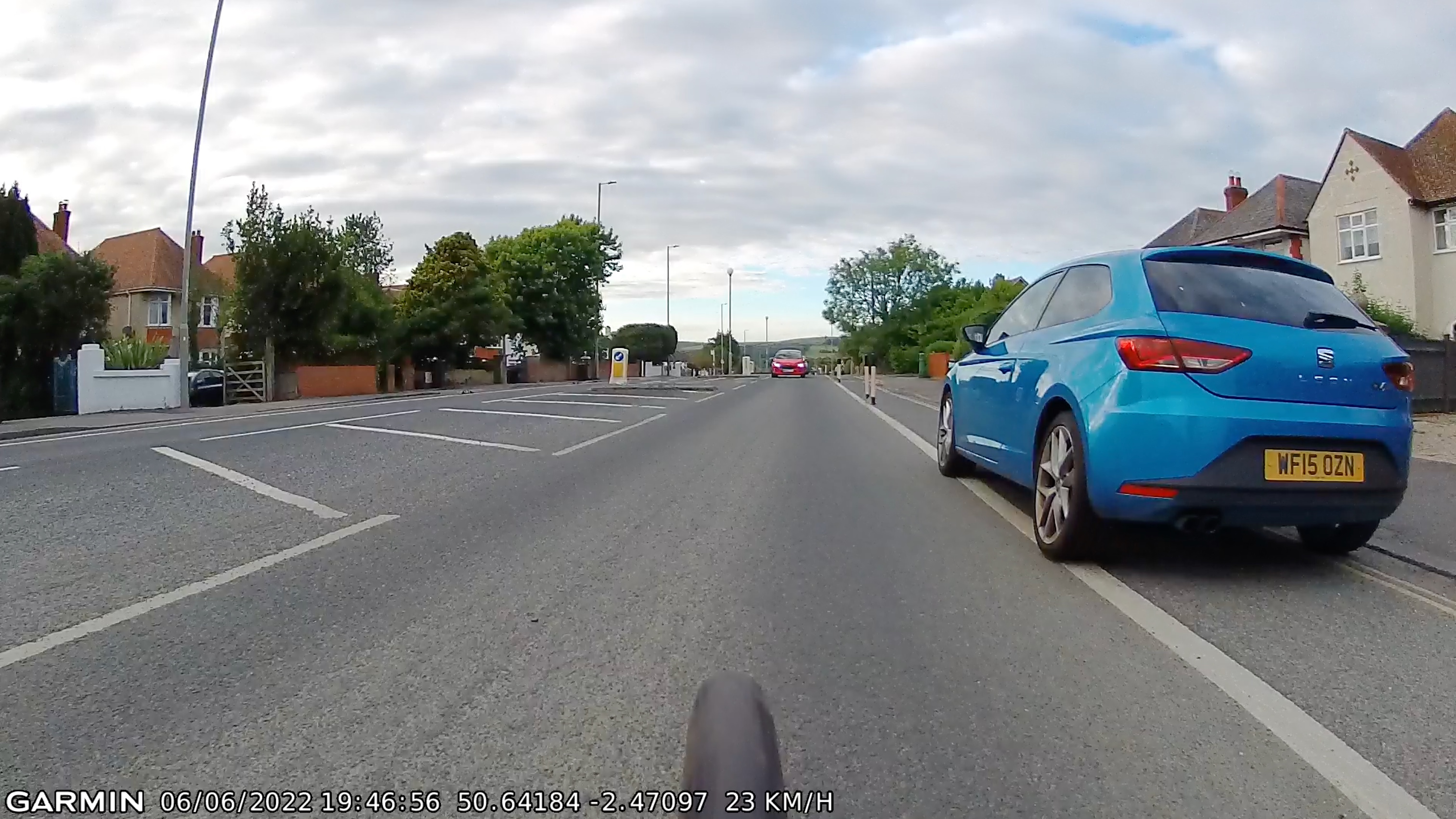

    Nothing edited in post on
    Nothing edited in post on that, straight out of the unit. The overlay can be configured to use time/date, GPS position, speed. All set by the head unit, so it’s switch on and go.
    Ref quality, the previous grab didn’t show the vehicle plate for obvious reasons, here’s another grab showing the clarity of number plates. I saved this clip while pulling out of a segregated bike lane to go around a parked car.
    https://cdn.road.cc/wp-content/uploads/roadcc/rct715image.jpg

    Image quality on the Garmin
    Image quality on the Garmin looks good, but I really like the time/location/speed overlay on the video. Have you added that in post or does the 715 get all that data streamed live from the head unit?
    If so, that’s another big advantage. Just having accurate time is a big plus, as the clock drift on the Cycliqs can be quite noticeable.
