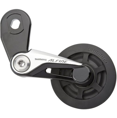

BikeJon
Just not the clean look I was
Just not the clean look I was after. But this will work perfectly well.

I’m fortuunate enough to own
I’m fortuunate enough to own lots of bikes. One of them is an Alfine 11 disc equipped dropped bar bike on a Planet X Kaffenback 2 frameset. I previously had this setup running on a Pompetamine frameset. I found the Alfine to be a B1**h on the horizontal dropouts of the previous frame as it’s really hard to get the rear wheel in the correct position, with the correct chain tension and then not have it rub on the rotors of the discs. I’d be fiddling around for ages getting it all right.
So you can imagine the pain it caused if I ever got a rear wheel puncture. I’ve switched to a vertical dropout frameset and this is much easier (I’ve used a half-link in the chain to get the chain tension right but also have an eccentric BB I can use when the chain stretches a bit).
The Alfine is also heavy and the gears can slip and splutter from time-to-time. My gear changes on my Versa levers have long travel and are a bit cheap, but I don’t believe this is an issue with the proper Shimano flat-mount Afline shifters. There is a Di2 version of Alfine, which has very rapid shifting indeed but I think the hubs themselves are prone to oil leaks.
