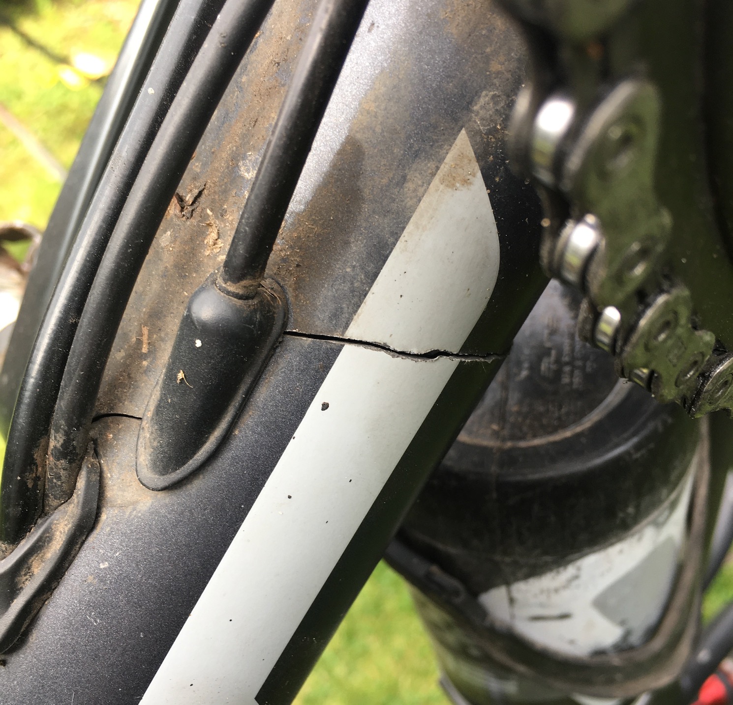

Literally just today I’ve discovered my frame has a massive crack in it just like the examples above. I was cleaning it after getting back from this morning’s ride and it was immediately obvious. But it wasn’t a there a couple of weeks ago.
Having initially thought this might be a costly problem (new bike scenario) I’ve done some Googling and found this thread.
I wonder if you could offer some advice about how you went about getting a warranty frame replacement. Did you contact Whyte direct or go through the distributor (ATB?). How old was your frame? I heard this problem is on 2014 frames – which mine is. However, I’ve done 3800 miles on mine, not the 38,000 that you did. Had you registered for the extended warranty? I hadn’t done that but I am the original owner.
I’d really appreciate any advice you could give. Many thanks in advance.

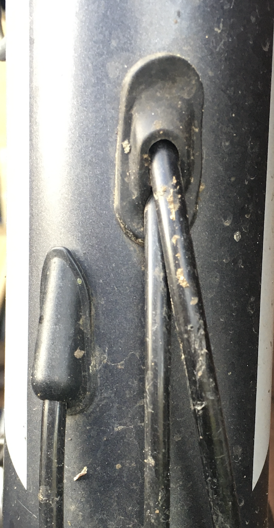

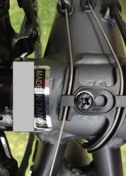

After your comment caused me to inspect the undercarriage of the bike a bit more closely than I’d ever done before, I noticed that the gear cables were being pulled a bit severely to one side, almost rubbing against the braze-ons. I also noted there was another hole that the cable guide could be bolted to, so I shifted the cable guide over towards the chainrings. What a difference! The gear shifts are now much lighter and snappier – can’t believe I’d ridden 10k miles with it like that!

Thanks HoarseMann. I did contact Whyte and they gave me a new frame! That was much more than I’d hoped – I had asked them if I could buy a new frame (but I’m not sure they sell just the frames). They asked that I take it to a dealer who charged me for moving all the bits off the old frame on to the new one and I was more than happy to give the LBS some business. Just picked up the rebuilt bike at the weekend and have done 100 miles on it so far: it’s lovely to have it back, and I was very impressed with Whyte customer care

The cable slots on mine look further apart than on yours, but not as far apart as some of the pictures on here. It makes me wonder how those slots are cut at the factory? If it’s done by hand and mk1 eyeball, then perhaps there’s some variability introduced in the production that will make some frames more prone to cracking than others?
Good job you noticed that
Good job you noticed that before it went pop. It’s reminded me to go and have a look at my frame. I don’t think I would spot it unless I was specifically looking.
Although you’ve had a lot of use out of it, it’s still a failure that shouldn’t happen, so perhaps worth contacting Whyte.

Well, five years later, and
Well, five years later, and after 38,000 miles, the frame on my 56cm Suffolk cracked like some of the others mentioned here.
I don’t think I really can complain – I had a lot of use out of the bike and really enjoyed it. I noticed the crack after having replaced the BB to fix creaking (it didn’t). I can only suppose the crack got bigger/worse quickly because I didn’t see it when I first started investigating. Not safe to ride now though.
