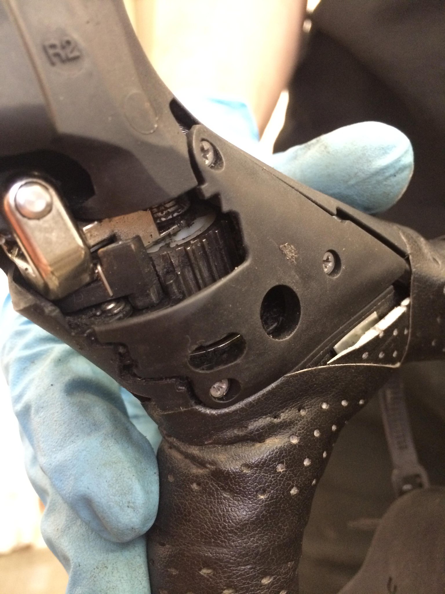

    Mr Jono
    Checked the spines, they’re
    Checked the spines, they’re in perfect nick so that’s one possibility eliminated.
    I washed out the lever mechanism and then blasted through some TF4 lube and that seems to have improved the feel of the shifting a bit.

    oddbydefault
    Had zero issues with Apex
    Had zero issues with Apex (and it still works just as well as the day I bought it 2.5 years ago) but the right hand shifter on my Rival equipped bike recently died after struggling for a while.
    This may not even be relative to your problem, and I have no idea if SRAM have fixed this issue for newer Apex stuff, but basically the splines got worn off the internal mechanism (see pic below) so it may be worth checking them out for wear as this obviously affects how it shifts.
    https://pbs.twimg.com/media/BoPDXq1IAAAJXlc.jpg:large
    I did get a free replacement one from Fisher even though it’s out of warranty though B-)
