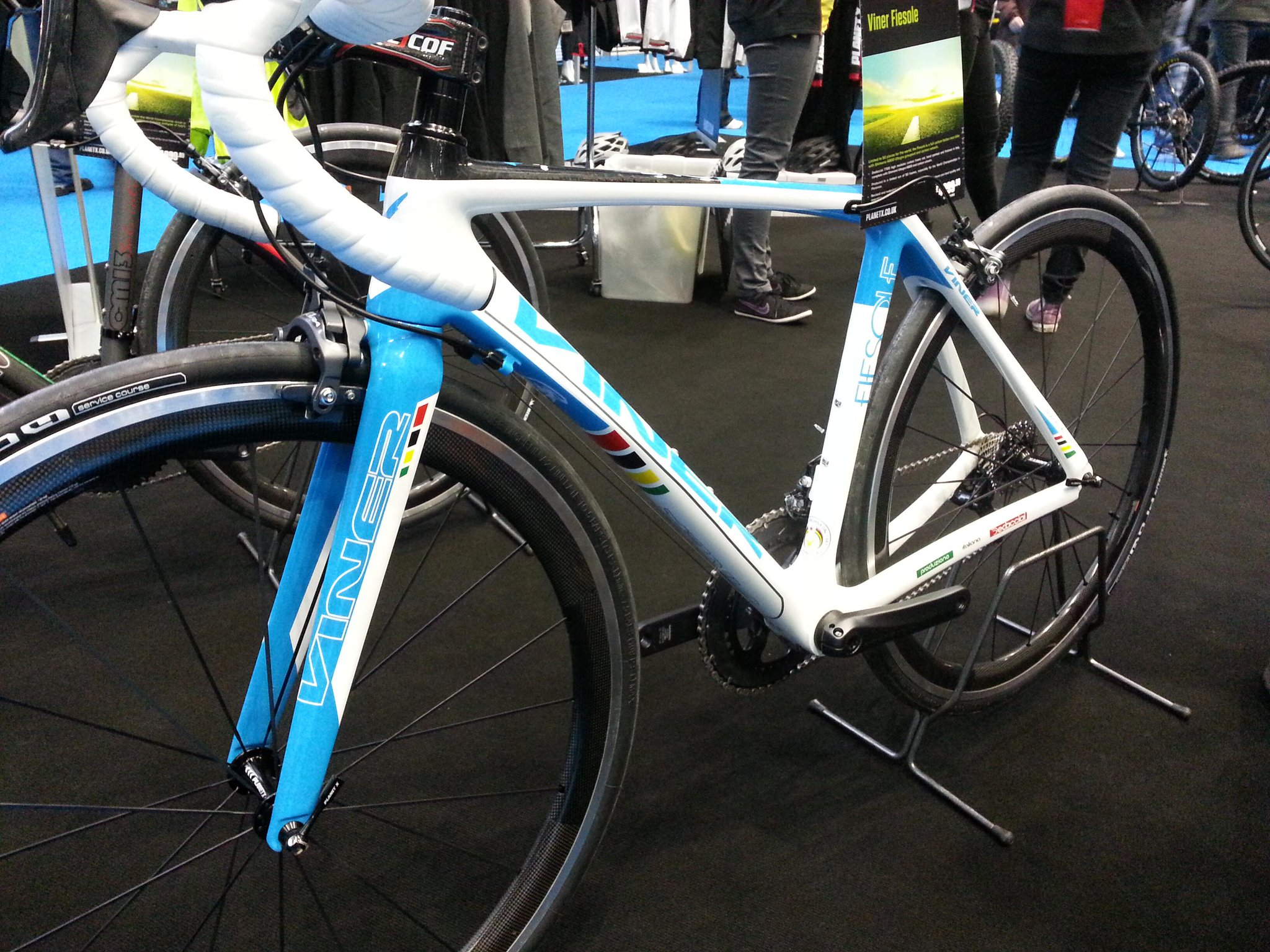

    I was at the Manchester Bike & Tri Show this weekend and they had one of these limited-edition models on the Planet X stand.
    https://pbs.twimg.com/media/BiM0D6TIEAACxy7.jpg:large
    It’s a virtually identical frame, only with internal routing for the rear brake cable. According to the Viner Facebook page it comes from Dedacciai, but a check on their website doesn’t show a matching model in their regular range. Note how it says its only ‘painted and finished’ in Italy?
