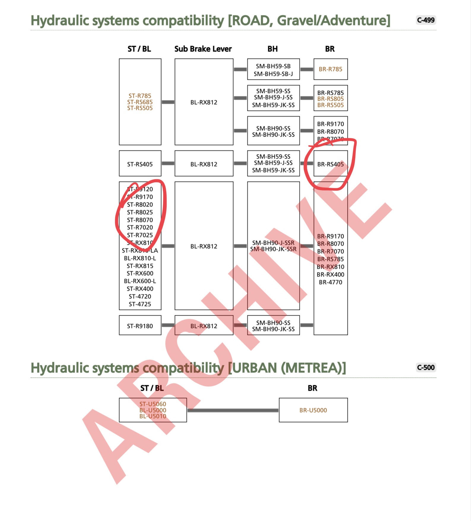

    #1015667
    mark1a
    It doesn’t appear that they
    It doesn’t appear that they’re officially compatible according to the chart.
    https://cdn.road.cc/wp-content/uploads/roadcc/IMG_0151.jpeg
    #1015669
    Achtervolger
    Thanks for your reply and the
    Thanks for your reply and the chart, really helpful.
