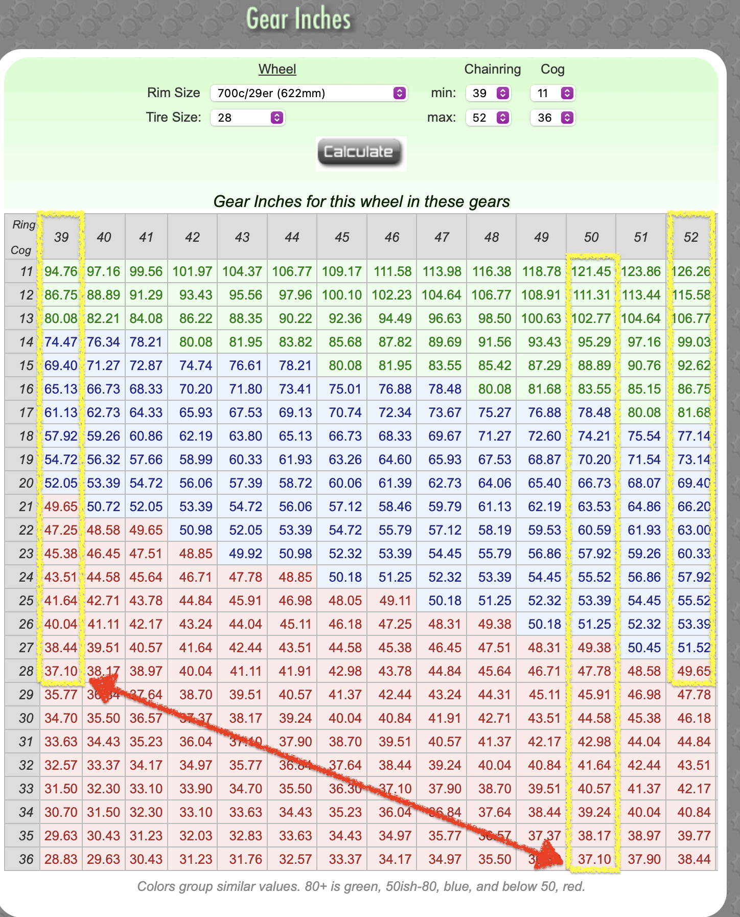

wycombewheeler
any inaccuracy on rolling
any inaccuracy on rolling diameter will apply to before and after equally, so really it’s just a question of ratios, and 39/28 appears to come out equal to 52/36 (less than 0.5% difference)

I’d look at putting some
I’d look at putting some numbers into a gear calculator – I can’t vouch for the accuracy of this site: https://www.bikecalc.com/gear_inches but it seems to indicate that the lowest gear on the setups you quote is the same at 37.10 inches. So the only downside to 1x would be bigger jumps between ratios and spinning out slightly sooner downhill.
