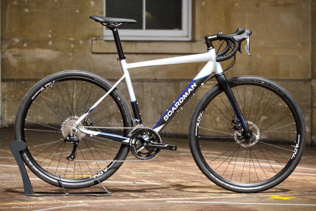

ADV stands for adventure, and this is exactly what Boardman has aimed the 8.8 at, a little bit of everything.
> Find your nearest dealer here
As Boardman points out, we don’t have thousands of miles of unsurfaced gravel roads so the company hasn’t gone down that route specifically, instead taking the fast-rolling features of a road bike with slightly more forgiving geometry for multi-terrain use.
Compared with its SLR Endurance Disc model, for instance, the ADV has a much more relaxed head angle at 70.5 degrees compared to 73 degrees, and a slightly bigger bottom bracket drop of 70mm to lower the centre of gravity and aid stability.

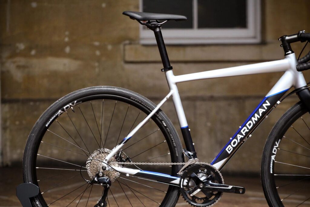

The ride

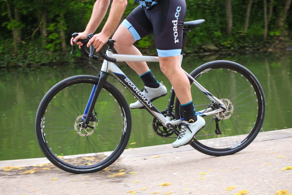

The slacker front end means the ADV 8.8 never feels twitchy on loose surfaces, with similar steering and handling off-road to the SLR Endurance on tarmac, which is confidence-inspiring, especially if you dart between the two terrains mid-ride.
On the road the ADV loses some of its steering sharpness but it never really feels ponderous through the bends. If you commute in all weathers this slower steering benefits in dodgy weather conditions like heavy rain or greasy, salt-covered winter roads.
With a tapered head tube up front and full carbon fork, stiffness is impressive which also helps in the bends.
The gravel tracks I have near me are mainly wide and flowing, covering hundreds of miles as they criss-cross Salisbury Plain, and the Boardman really was fun to ride in this type of surroundings. It was being tested at the same time as the Canyon Grail, which is a much faster, more aggressive gravel machine, but I never thought of the Boardman as the softer option; a more relaxed ride maybe, but never dull.
Fast, rocky descents took a little more concentration to get the perfect line, and away from the Plain where the gravel tracks and twisty hardpack trails are a little more technical a more methodical and calculated approach was required, but ride the ADV 8.8 in isolation and you’ll find it a fun and solid performer.
As standard, the Boardman comes with Schwalbe’s G-One Allround tyres and they are very good, both on and off-road.
If you are going to spend a lot of time on the tarmac, though, as a commuter for instance, then a switch to some slicks will make for a better ride. I tried the 8.8 with both a set of 28mm road tyres I had knocking about and the 30mm-wide inverse treaded Ritchey Alpine JBs, and that really made for a fun cruising machine for the likes of commuting or day trips.
The bike rolls well, so you can cover some decent distance, and its all-in weight of 10.57kg never really feels like a hinderance under acceleration or when climbing. Boardman has specced a 48/32t chainset option plus an 11-32t cassette so you have plenty of low gears to get you up the steep stuff anyway.
Like a lot of other bikes at this price point, the ADV 8.8 is fitted with a set of mechanical TRP Spyre-C brake callipers and while they are one of the better ones, braking performance can be… how can I put it?… challenging.
You really need to pull them on hard if you need to stop from speed and there can be a few heart-stopping moments if you aren’t planning ahead. There isn’t a huge amount of feel or modulation and in the dry you aren’t really benefiting over a good set of dual pivot rim brakes, though you are obviously reaping the benefits in the wet.
You’re also experiencing less wheel wear if you ride and commute year-round: it’s much cheaper to replace a rotor than a wheel rim.

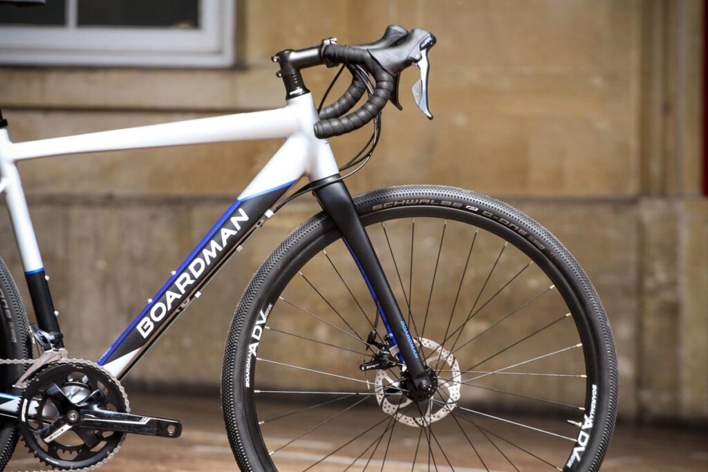

Frame and fork

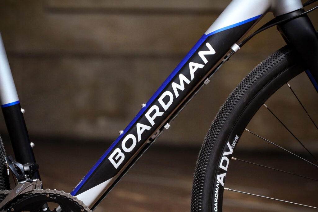

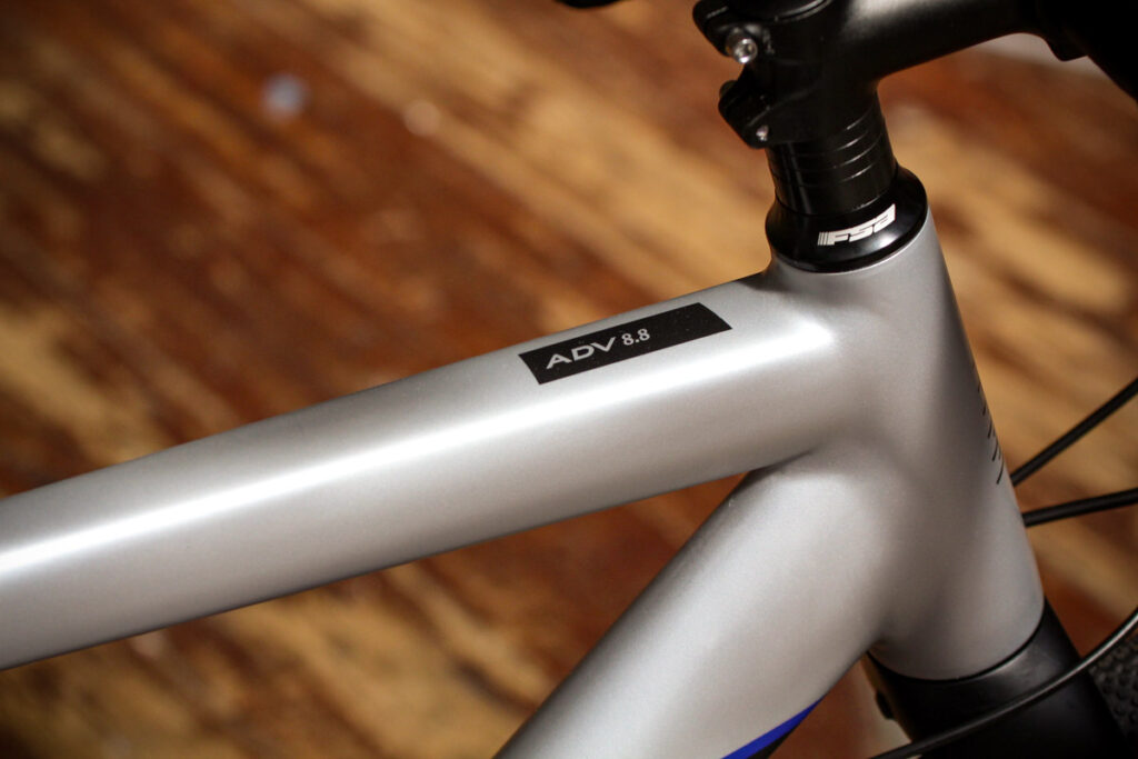

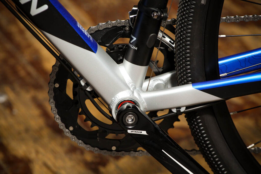

Boardman has created the frame from 7005 aluminium alloy and it looks and feels to be well made, with a smooth finish to the welds and a tough paintjob.
The graphics look pretty cool, too, to my mind making the 8.8 look a more expensive bike than it actually is.

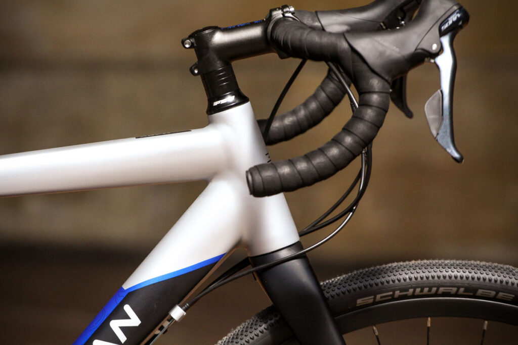

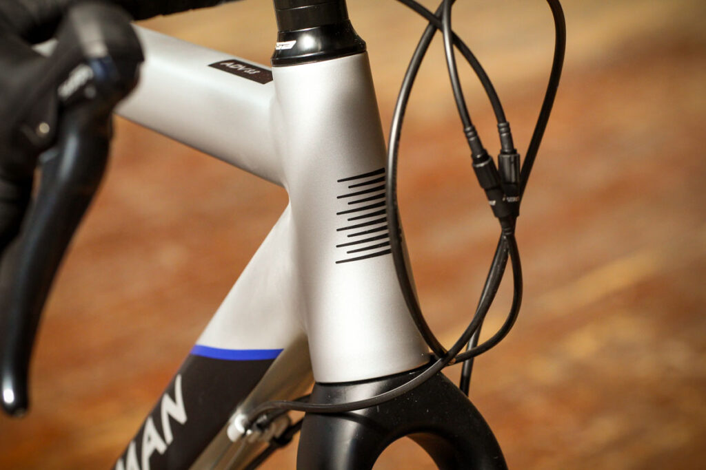

As I mentioned above, the head tube is tapered, which is standard fare these days but still good to see at the lower end of the market. It goes from 1 1/8in at the top to 1 1/2in at the bottom for maximum stiffness under braking and steering. It also allows for a larger crown diameter on the full carbon fork fitted to complete the package.
All the tubing is on the larger side when it comes to diameters, although very few of them are actually round. It offers a firm ride, but like a lot of alloy bikes these days, it isn’t harsh.

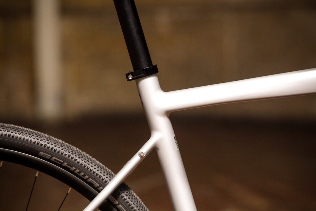

The top tube tapers down as it gets near to the seatpost for added comfort, and the larger diameter seat tube (it takes a 31.6mm seatpost) paired with the down tube and chunky chainstays work in the opposite direction, to create a stiff bottom end for power transfer.

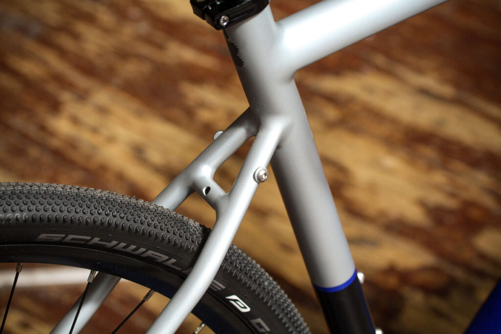

Those who aren’t fans of creaks will be glad to see that Boardman has gone down the threaded bottom bracket route.

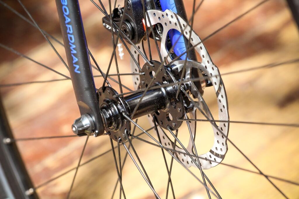

One thing we have seen trickling down through the price range is the adoption of thru-axles front and rear, but Boardman has stuck with traditional quick releases here for both the rear dropouts and the fork.
Thru-axles, if you don’t know, are tubes that pass through the frame and fork one side and are screwed into a threaded part on the opposing side, locking them into the bike. It adds a level of security over QR skewers, as in the wheels can’t drop out even if the thru-axle was to loosen, plus there are some benefits at the fork as it helps resist twisting forces under braking on account of the rotor only being attached to one side of the wheel.
Quick releases aren’t redundant, though, and they worked fine throughout the test period, especially as the brakes here don’t have the amount of power that a hydraulic setup has.
The frame and fork are set up for flat mount callipers for a smoother look than post mount options.

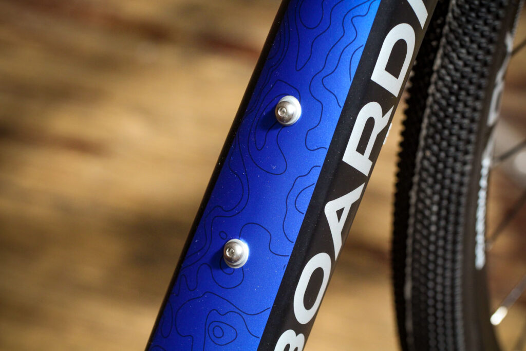

I mentioned earlier about using the ADV 8.8 for commuting, and to make this more pleasurable it comes with a full complement of mounting eyes for mudguards and a rear pannier rack. You also get two sets of bottle cage mounts.
It’s getting quite rare to see a frame that still has external cable routing but the 8.8 does use various guides to keep everything looking neat and tidy as it passes underneath the down tube.

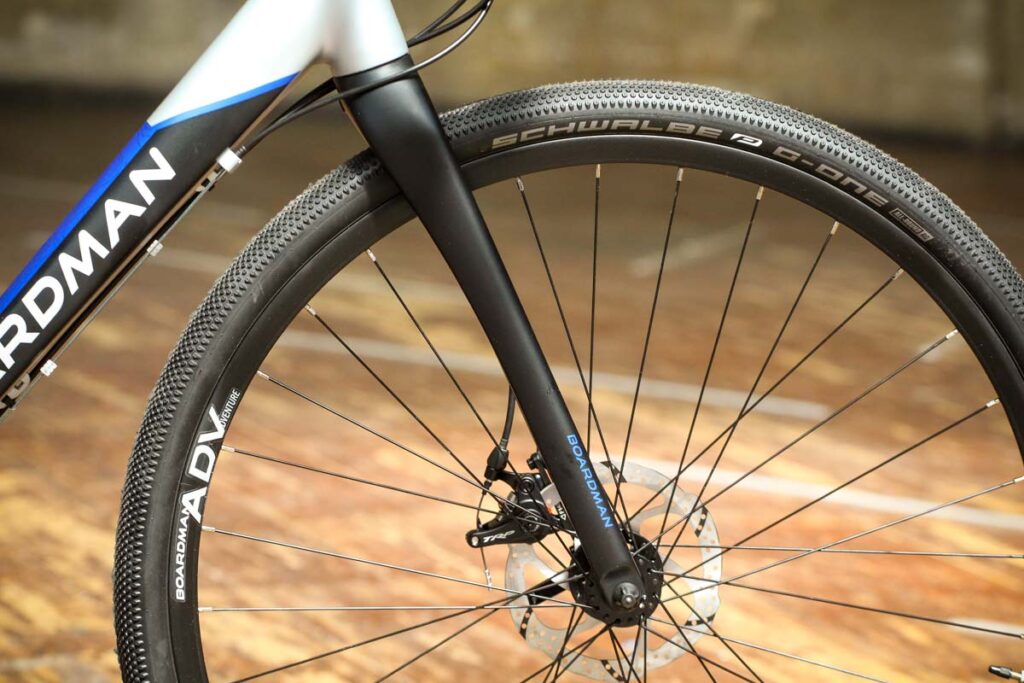

Wheels and tyres

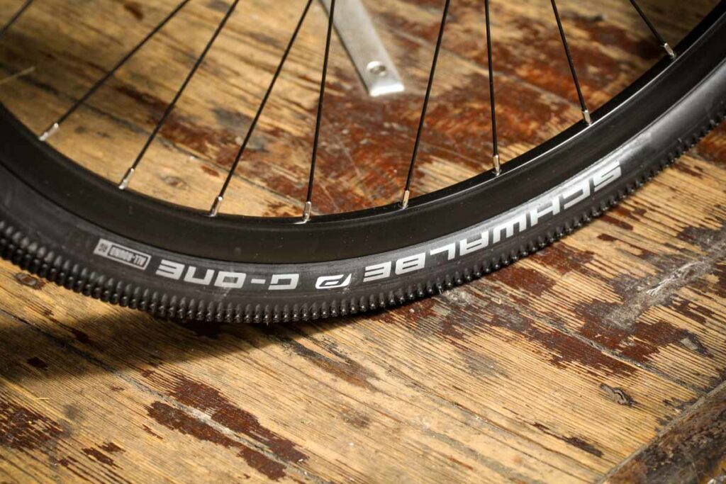

Speccing Schwalbe’s awesome G-Ones as standard is a bit of a masterstroke by Boardman, as they are great all-rounders perfect for the ‘bit of everything’ style of the ADV. They are fast on the road and grippy too, and take most things in their stride away from it; they’re especially suited to hardpacked gravel and firm, dry forest trails.
The trade-off is that they can be a little fragile, which I have found through testing them on various other bikes, but I had no issues here.

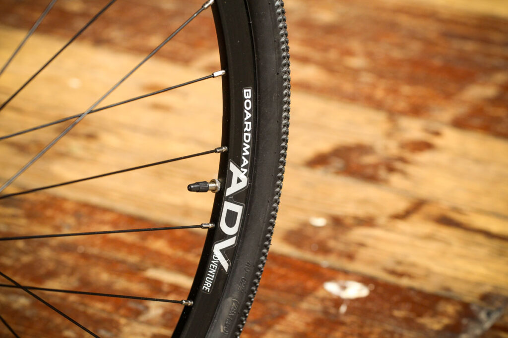

Boardman provides its own wheelset, made up of ADV tubeless ready rims mated to Formula hubs. It’s not a massively exciting package but it works well and the wheels feel very solid, taking plenty of abuse on the trails. Both the front and rear use 32 spokes set up in a two-cross pattern for strength.
The bearings feel smooth and the pick-up from the freehub pawls is quick enough so I’d be happy to leave these fitted to the ADV without worrying about an upgrade – not something I often say when it comes to bikes below a grand.

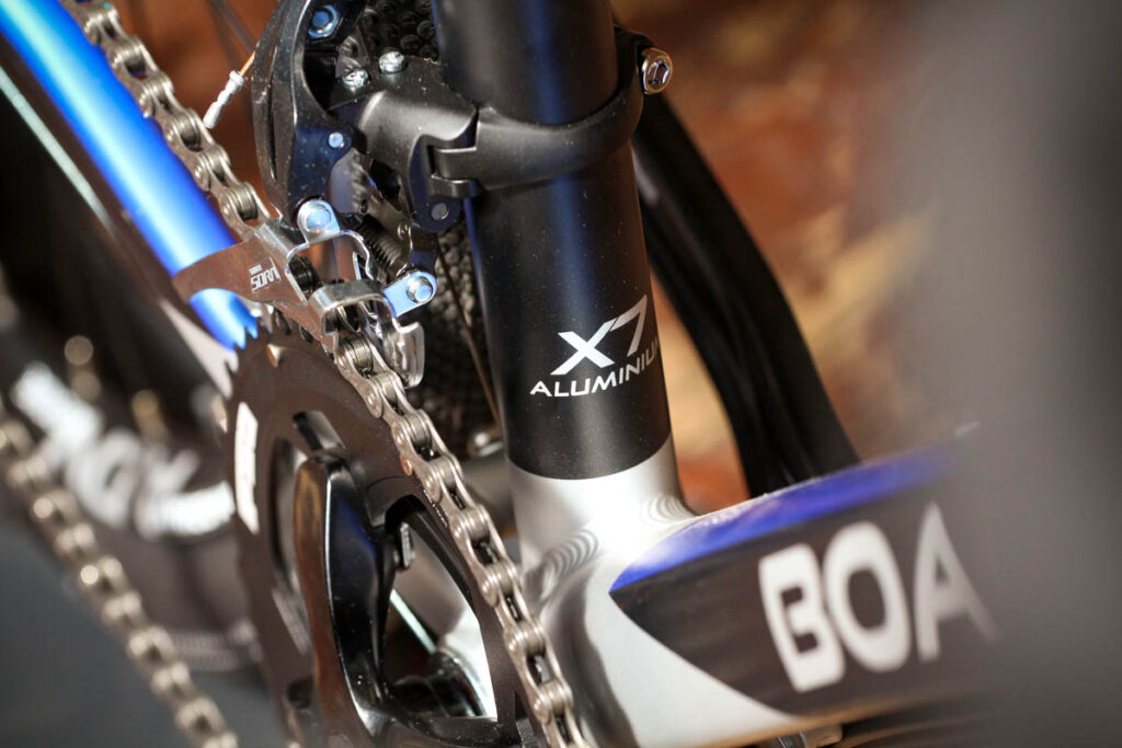

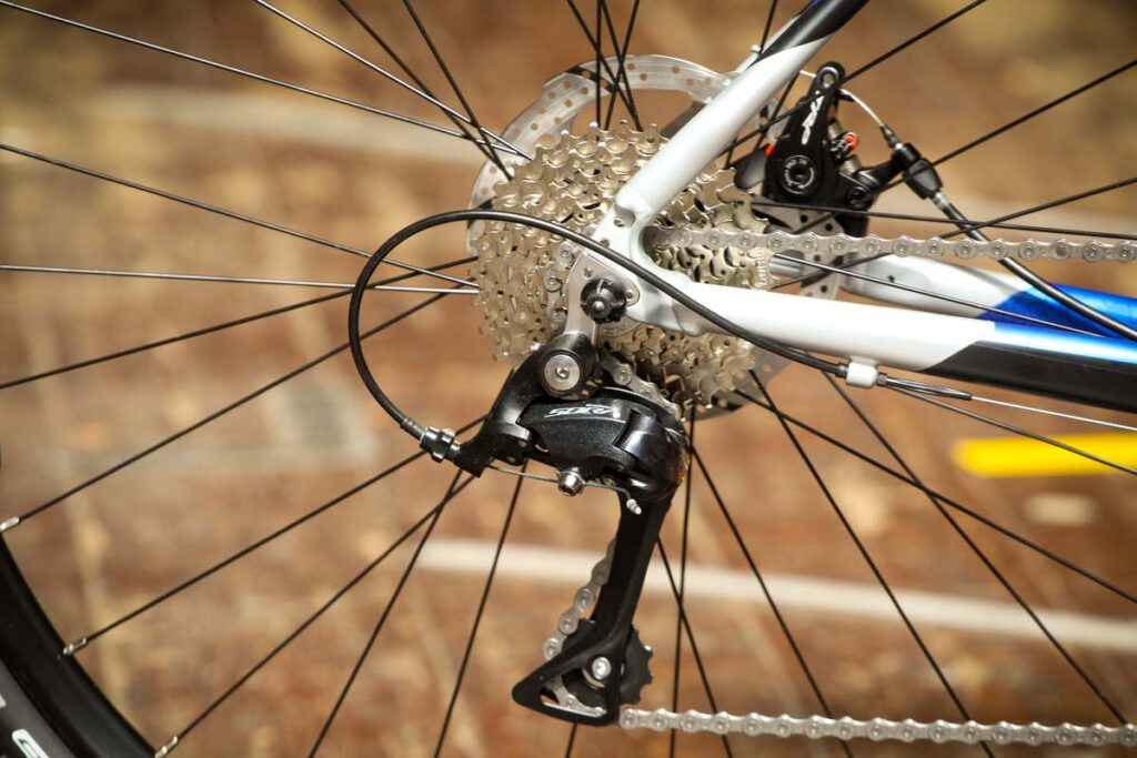

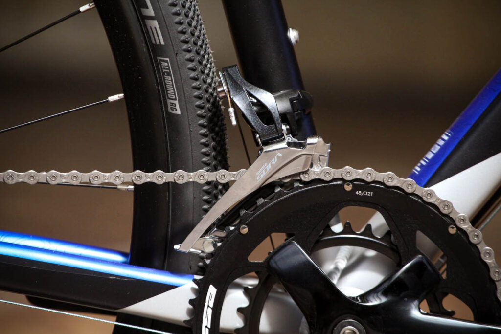

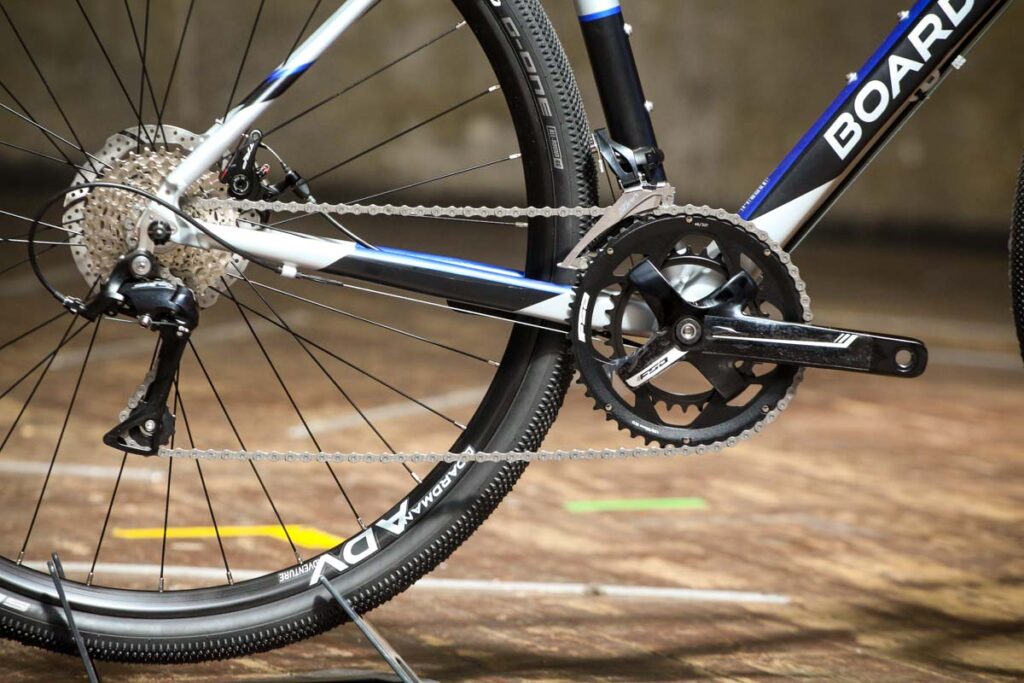

Shimano provides the majority of the drivetrain by way of its 9-speed Sora groupset. It’s great kit and good to see here as the shifting is positive and the gear/brake STI levers are a joy to use.
As they mimic the design of the 105 5800 shifters and those of the next level up Tiagra model, there is very little to separate them other than the fact that those two get an extra sprocket or two.
> Your complete guide to Shimano groupsets

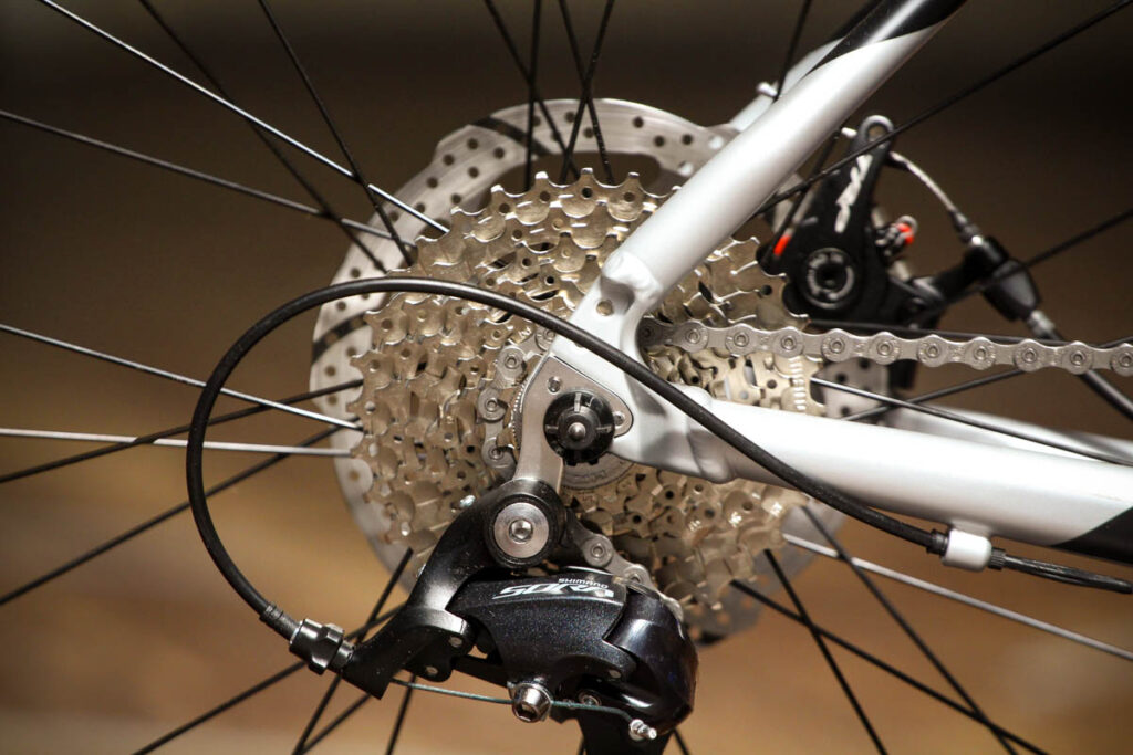

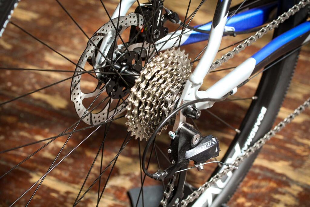

The cassette we have here ranges from 11 to 32 teeth (11-12-14-16-18-21-24-28-32), which as you can see has pretty close jumps at the bottom of the sprockets but they get larger towards the bigger ones. A jump of four teeth is quite noticeable but as they are predominantly for the bailout gears, I could live with it.

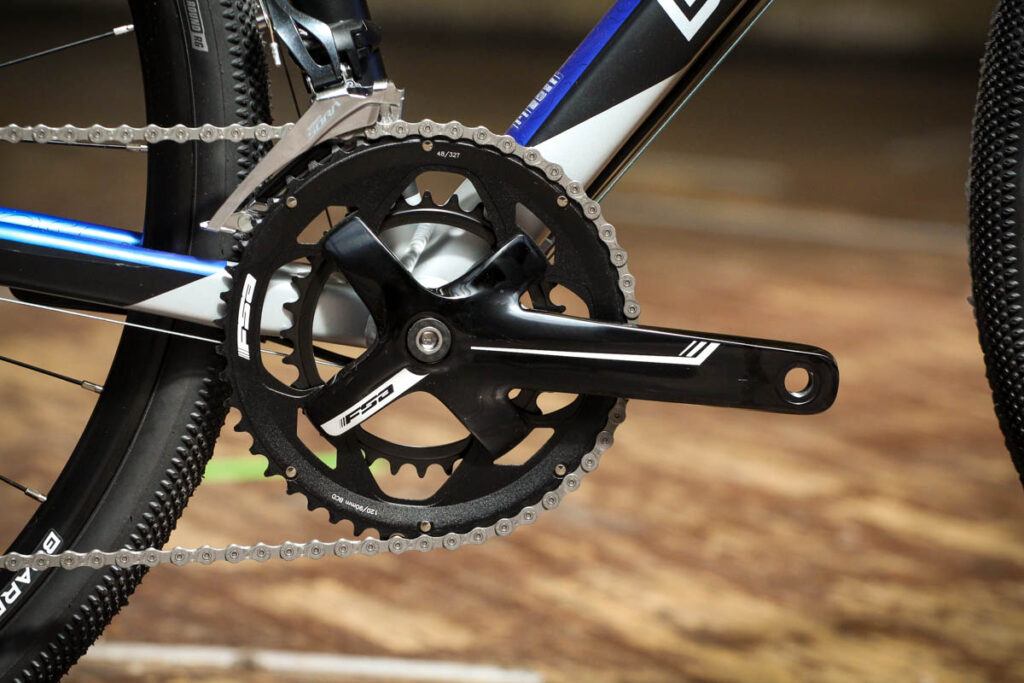

FSA has supplied the chainset, primarily because Shimano doesn’t offer a 48/32t chainset option in Sora. The FSA shifts across chainrings fine, and even though it looks a little dated with its cartridge bottom bracket setup, there is no need to rush out and upgrade.

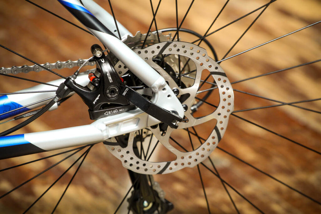

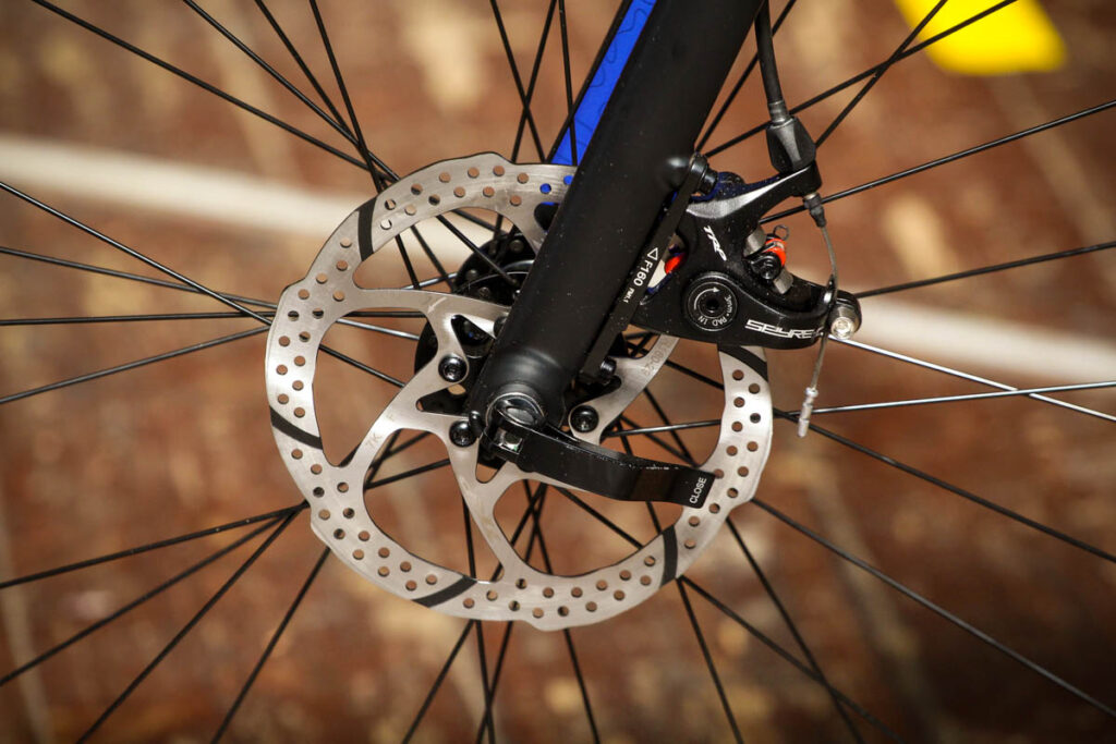

TRP Spyre-C mechanical brakes are starting to become the norm on bikes of this price, but as I said above they aren’t the most powerful, even when paired with the 160mm diameter rotors. I ride a lot of disc-equipped bikes and most of them have hydraulics so I probably notice the difference between them and the Spyres more so than someone coming from cable-operated rim brakes, but just don’t be expecting anything amazing in terms of a performance upgrade.
Unlike a lot of mechanical disc options, the Spyre-Cs do move both pads onto the rotor so you get equal pressure applied. A lot of others on the market have just the one side that moves, pushing the rotor across to the stationary pad, so the Spyres do have a benefit there.

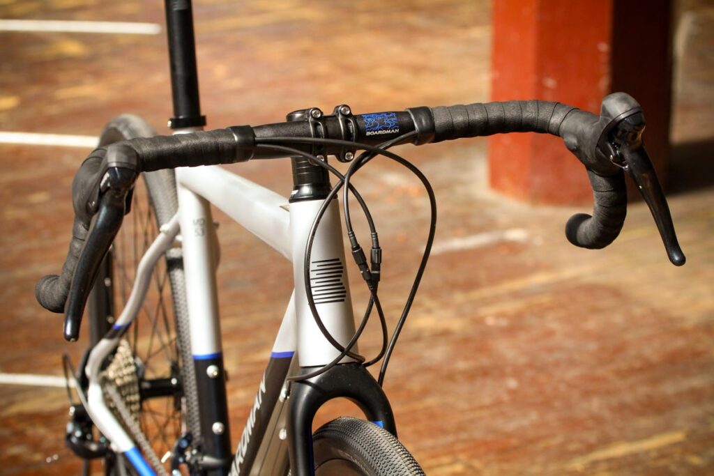

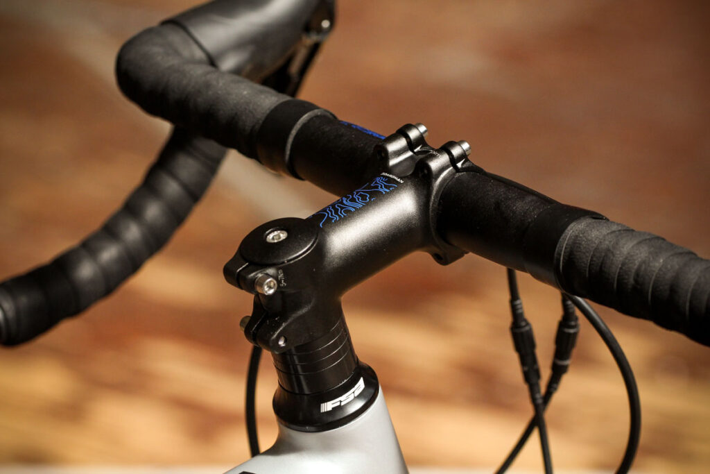

The aluminium alloy stem does the job, and like most adventure bikes you get a shorter length fitted than you would to the equivalent road machine: just 80mm here on the ADV 8.8.
I’m a big fan of a flared handlebar on bikes designed for off-road use, as it gives a bit more stability when you are flying along in the drops. At the hoods it measures 440mm across but that increases by quite a bit by the time you get to the bottom.
The bar is again an alloy offering but it is stiff enough for hauling up hills or when you load it up when cornering hard or braking.

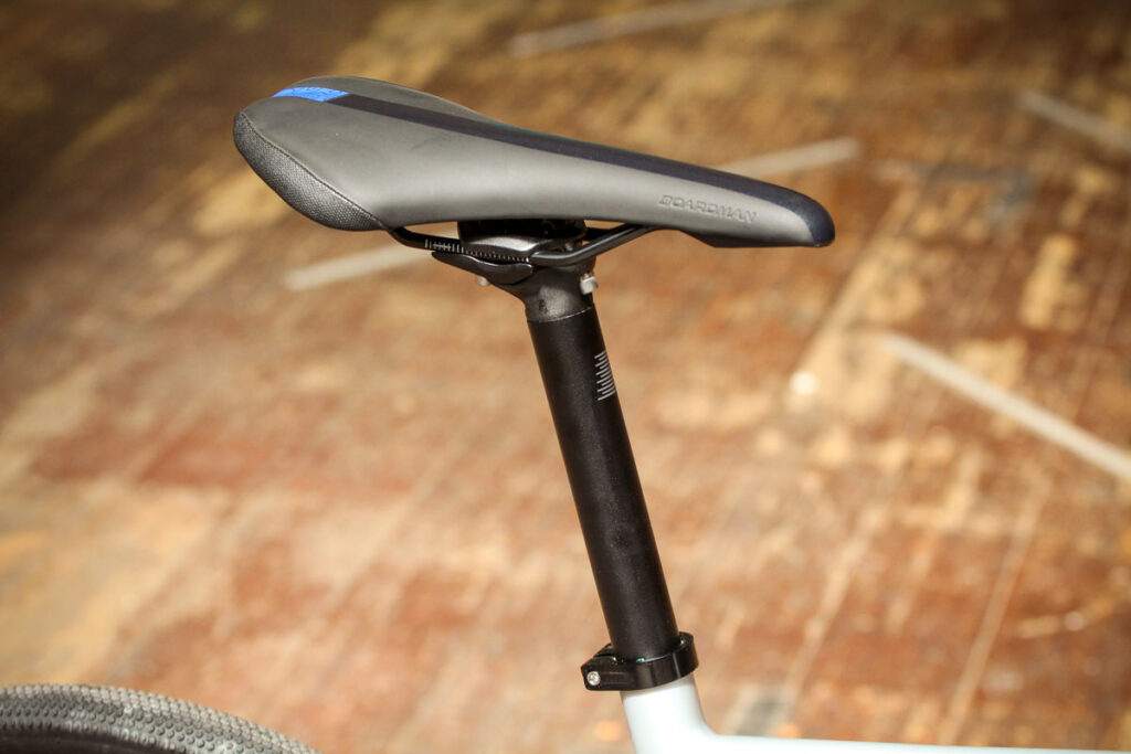

On all its bikes, Boardman seems to favour a 31.6mm seatpost over a narrower 27.2mm option. It is a minimal difference but going for the smaller option promotes a little more flex for comfort, especially if you swap out the standard alloy one for a carbon fibre post.

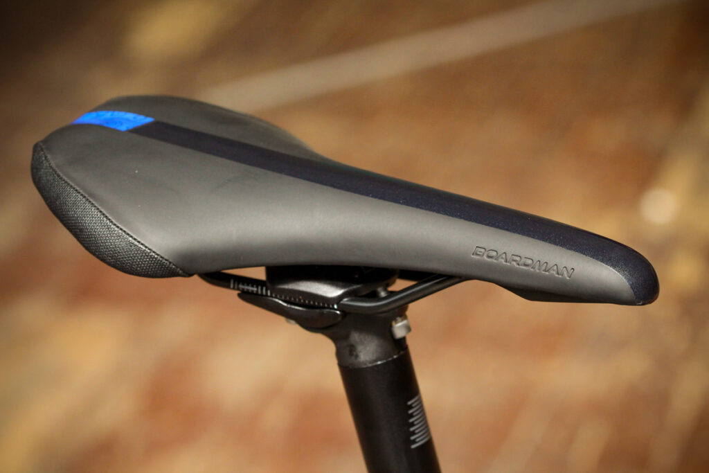

One thing that I wasn’t totally enamoured with was the Boardman Road by Velo saddle; I just didn’t really get on with the shape or its firmness. It’s a personal thing, though, and swapping to a trusted favourite isn’t a major hassle.

check12 wrote:
If you can’t brake properly using a pair of RX100 dual pivots in any conditions then it’s any wonder you have the hand strength to even take a tyre off a rim, it’s hardly requires any hand strength to do the former.
BehindTheBikesheds wrote:
my hand strength is fine but there’s a difference between braking on a flat road and stopping from 35mph on a 15% grade, and grip strength is a good indicator of how long you will stay independant in old age, so everyone get yo captain crush on.
Not doubting Stu’s experience
Not doubting Stu’s experience of this test bike at all, but I have to say that on my bike – with Apex levers – Spyres are absolutely brilliant. Jagwire compressionless cables and setting them up properly works wonders.
I have ‘cheat’ or ‘cross’
I have ‘cheat’ or ‘cross’ brakes on mine and find these offer more power/immediate braking and modulation (though less travel), I think a lot of the issue could be in the lever travels…
I have the ADV 8.9 a year now
I have the ADV 8.9 a year now and it is a decent bike. I thought I’d post a little review here as there are few reviews of the 8.9 online so people end up at this review. There’s now a 9.0 as well, using the same frame I think. I bought the 8.9 because it was the cheapest gravel bike with decent (tiagra) hydros, and still is, though it now has a competitor in the Vitus range with almost the same spec and price.
The compromise you would expect at this range is there in the form of pretty heavy wheels. On the plus side, I went down rocky bridlepaths in the Peak District with loaded panniers and they withstood everything, so no real complaints.
The other downside is something I’ll have to disagree with this review on: I think the frame transmits too much bumpiness from the road. I’ve had Cannondale and Giant frames in the same price bracket that were a much smoother ride. This is one thing I do wish were better, and if I had to buy again I might try the Vitus just to see if the frame had a smoother ride. Still, it’s totally rideable and takes everything you throw at it (I commute and ride on countryside trips) so not the end of the world.
The one thing they can and should change is that FSA bottom bracket and crankset. The BB is crap and an internet search will reveal many similar experiences. I got a creak after about 5 months. Also there’s only FSA replacements unless you change the cranks too, as they use a non-Shimano size – which is really annoying. So I’ve had to replace the crap mega-exo 4000 with exactly the same. By 10 months when I was changing out the chain and cassette I discovered the FSA chainrings were worn much more than you’d expect. I’ve never had chainrings wear out before so that was a nasty surprise. It wouldn’t even take the Shimano chain and we had to fit a KMC one which apparently has more give. Next time I change the chain and cassette I’m expecting to have to change the chainrings as well. At that point I may well end up replacing BB and cranks with Shimano, which is expensive but would be worth it for less grief. Alas the Vitus appears to have exactly the same crap BB and cranks. I’d pay £30 more on the price not to have such poor quality parts, which I suspect is all they saved.
A word on the Tiagra hydros: they’re not bad, but not quite the step change I thought they would be from good mechanical disc brakes. I didn’t think much of the lauded Spyres but had good experiences of BB7s and the best experience of the little-known Shimano CX77s. I would totally buy another bike with the latter brakes. I wish they’d standardise brake pad sizes – there’s not a lot of choice for the Tiagra pads and the Shimano ones are only passable.
Anyway, it’s still a pretty good package for the price. Boardman just need to get rid of that shonky FSA kit to make me recommend the bike.

I have FSA Mega Exo 4000
I have FSA Mega Exo 4000 Threaded BB with the 48-32 cranks. So far I’ve done 2700 miles, only needed the threads re-greasing once so far, chainrings are ok.
Pinnacle Arkose 1 model is an alternative to the Boardman. It looks to be heavier although does come with wider/heavier tyres. When I’ve test ridden another Boardman the actual weight was 0.8kg more than the published weight/on their website.
Regarding braking I’d prefer Hydraulics but happy with the performance of the TRP Spyres with Jagwire compressionless housing.
