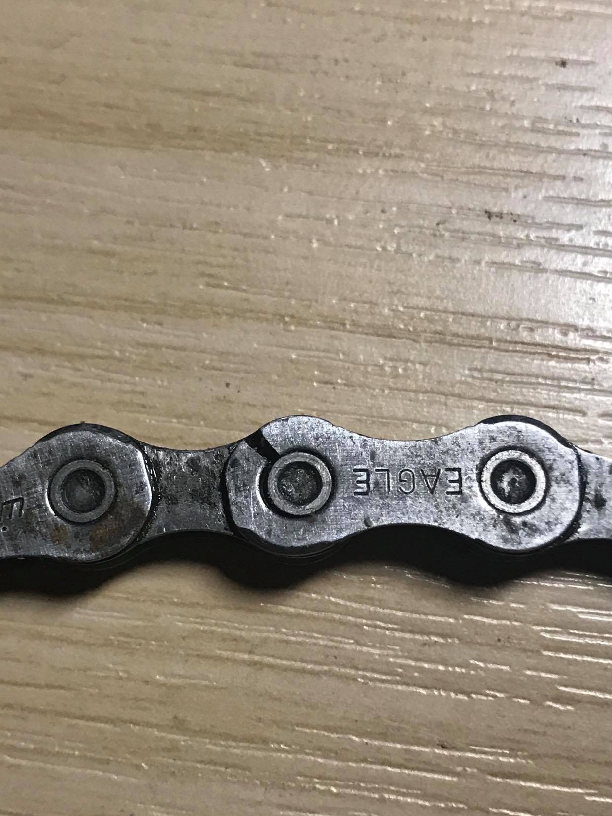

    A friend had something very
    A friend had something very similar. SRAM chain on a new bike – within a few weeks it had multiple cracked plates… I noticed when I was fixing his chain for the second time on the same ride
    SRAM replaced it under warranty (via the bike manufacturer)
    https://cdn.road.cc/wp-content/uploads/roadcc/122447532_417936386268566_221699587366505806_n.jpeg

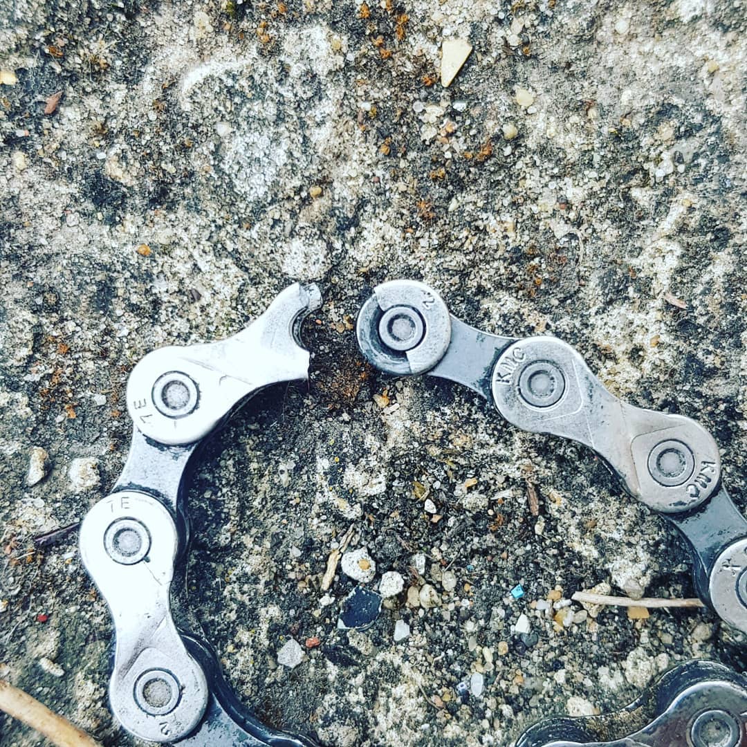

    #995417
    I think multiple links in the
    I think multiple links in the chain crack, so get weakened, and when you put a load through the pedals, in my cases its been to pull away from a stop or hitting a steep hill, and Im not generating stupid power I might be rugby player weight Im not rugby player fit, in that split second as the load spreads across the chain the weakest links fail.
    this picture gives you some idea, as you can see the link to the left/down of the broken one is showing a hairline crack as well.
    and it had only done at most half the mileage Id expect from it given it was basically only dry weather use and was in good nick for wear.
    Ive had 3 chains break in 20 years of riding and 2 have been KMC chains within the past 2 years.
    https://cdn.road.cc/wp-content/uploads/roadcc/116012860_737475940386267_2340264905934609747_n.jpg
