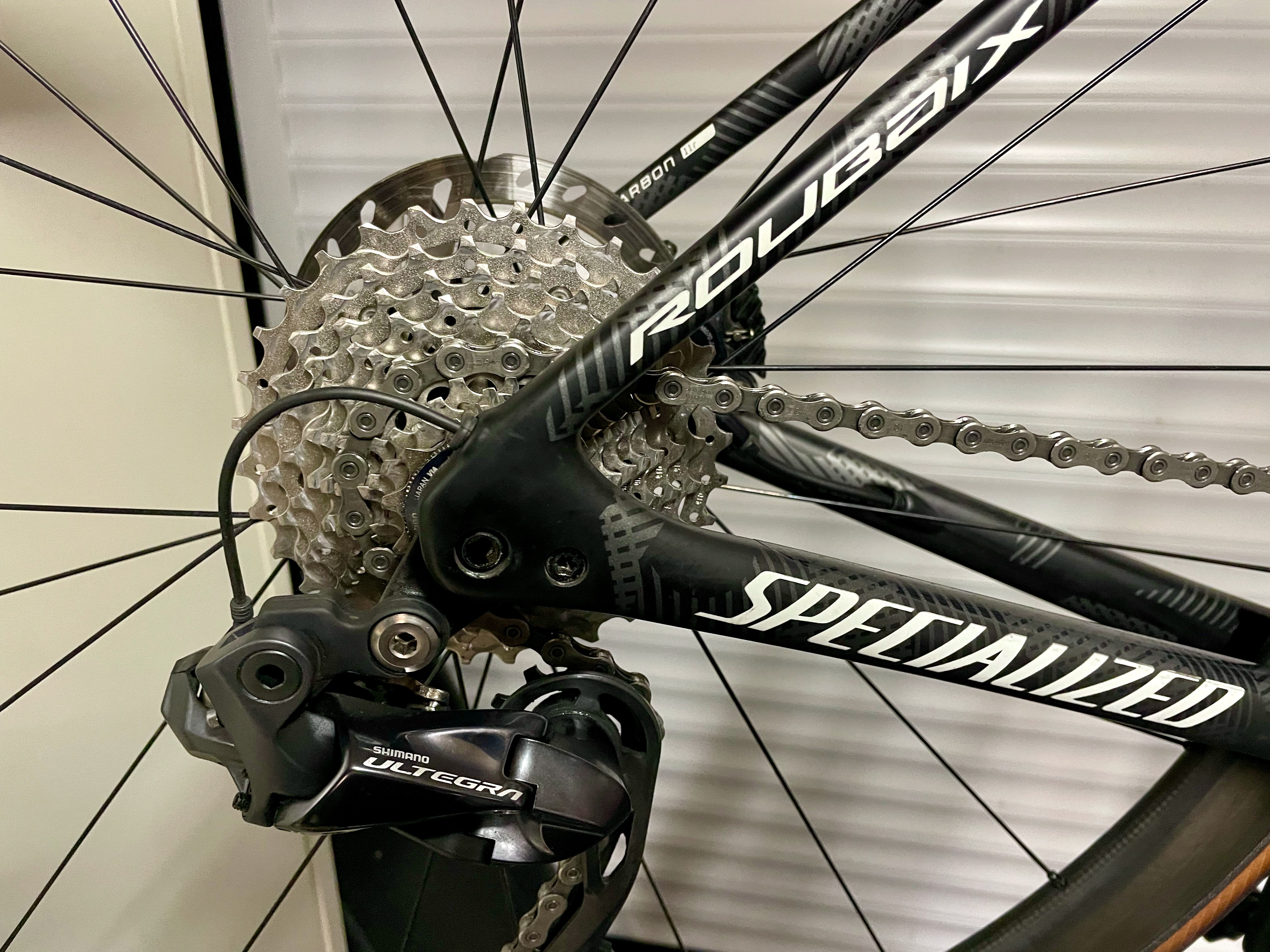

HoldingOn wrote:I think I would benefit more from improving my chain cleaning process. bikes’ idea of a jar of spirits/degreaser with a mesh in the bottom, followed by an oil bath sounds like a good starting point. Depending how I go, I might then started experimenting with waxing my chain.I picked up an ultrasonic cleaner a couple of years ago, and use that with a degreaser. After getting fed up with paying £15 a litre “bike tax” for the “bike brands”, I took a recommendation from a fellow traveller on road.cc and now use the Screwfix No Nonsense degreaser at £12.99 for 5 litres. A light agitation with a paintbrush in 5:1 water solution, followed by 20 minutes at 40 deg C in the ultrasonic tank works wonders.
Here’s my pre-RideLondon service from last week:
