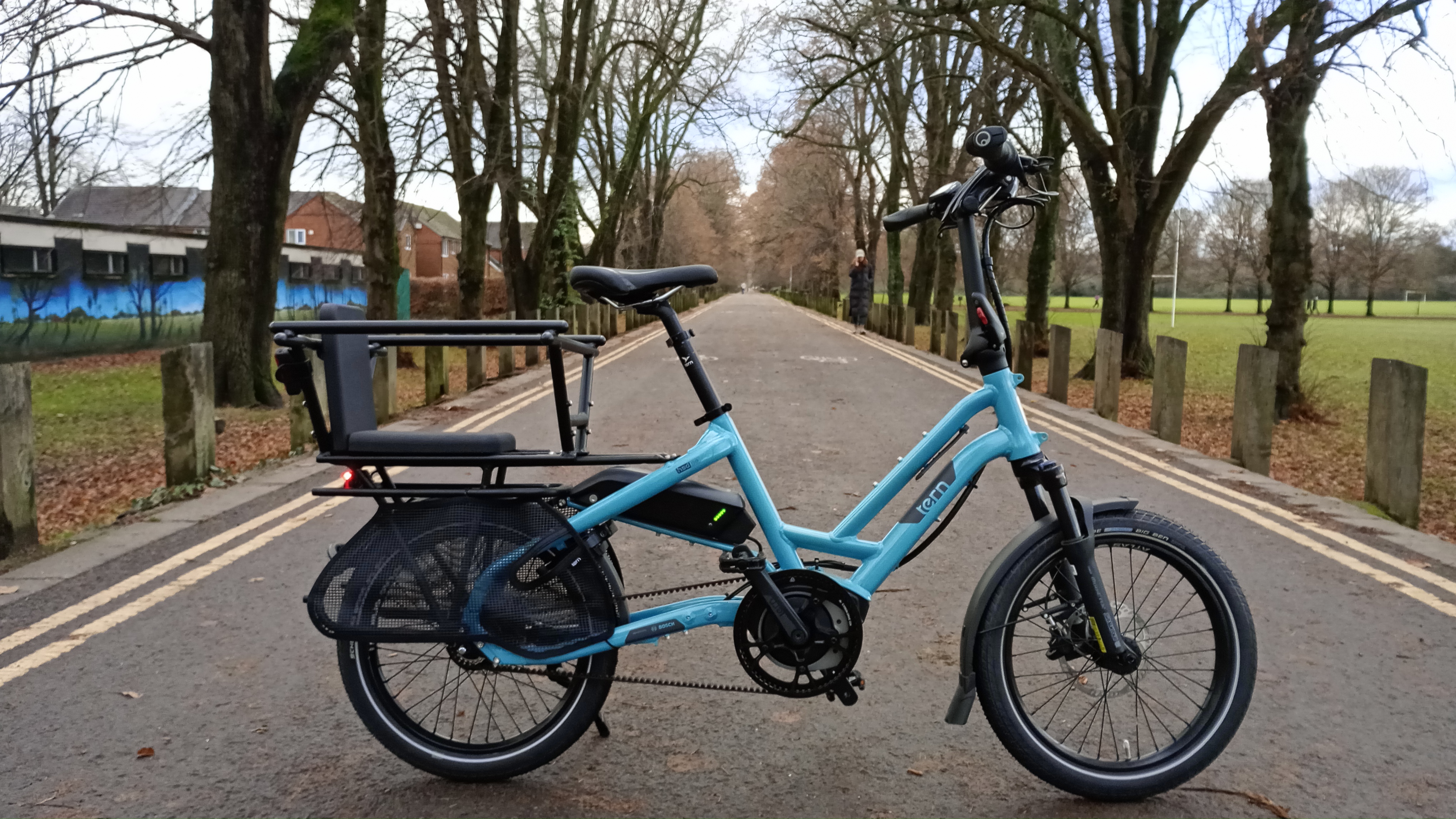

Yes! She graduated from a
Yes! She graduated from a Hamax child seat on a normal bike to this overnight, so is luxuriating in the extra space (and I’m loving her lower centre of gravity!) She was a bit unnerved at first (and if I’m honest, so was I ) by not being strapped in, and I need to add some foot stirrups to give her something else to brace against (we had a firm but not emergency stop yesterday that sent her sliding into my back!) but she’s loving it. She also loves peering round at the speedo to tell me how fast I’m going.

quiff
Thanks for the advice. It
Thanks for the advice. It feels like something that can be adjusted / will bed in rather than a catastophic issue, but is it too much to ask that something this expensive just works from new?!
Creakingcrank
Looks great! Adjusting a
Looks great! Adjusting a Nexus 8 usually just involves putting it in 4th and twiddling the cable barrel at the shifter until the two yellow marks on the hub actuator thingy line up. For what it’s worth, I’ve always had better results using a trigger shifter for Nexus hubs, rather than the standard twist grip. And despite Shimano’s claims to the contrary, mine have never liked shifting under load.

Finally, 2 months after
Finally, 2 months after receiving the bike, got hold of the seating accessories and managed to use it as intended. Tern have redesigned the seating, so that slim seatpad and backrest you can see set me back £105! Unfortunately the Nexus gear hub seems to be slipping which, from a quick google, seems not uncommon. Unfortunate because I bought remotely, so taking it back for inspection / adjustment etc is not straightforward.
