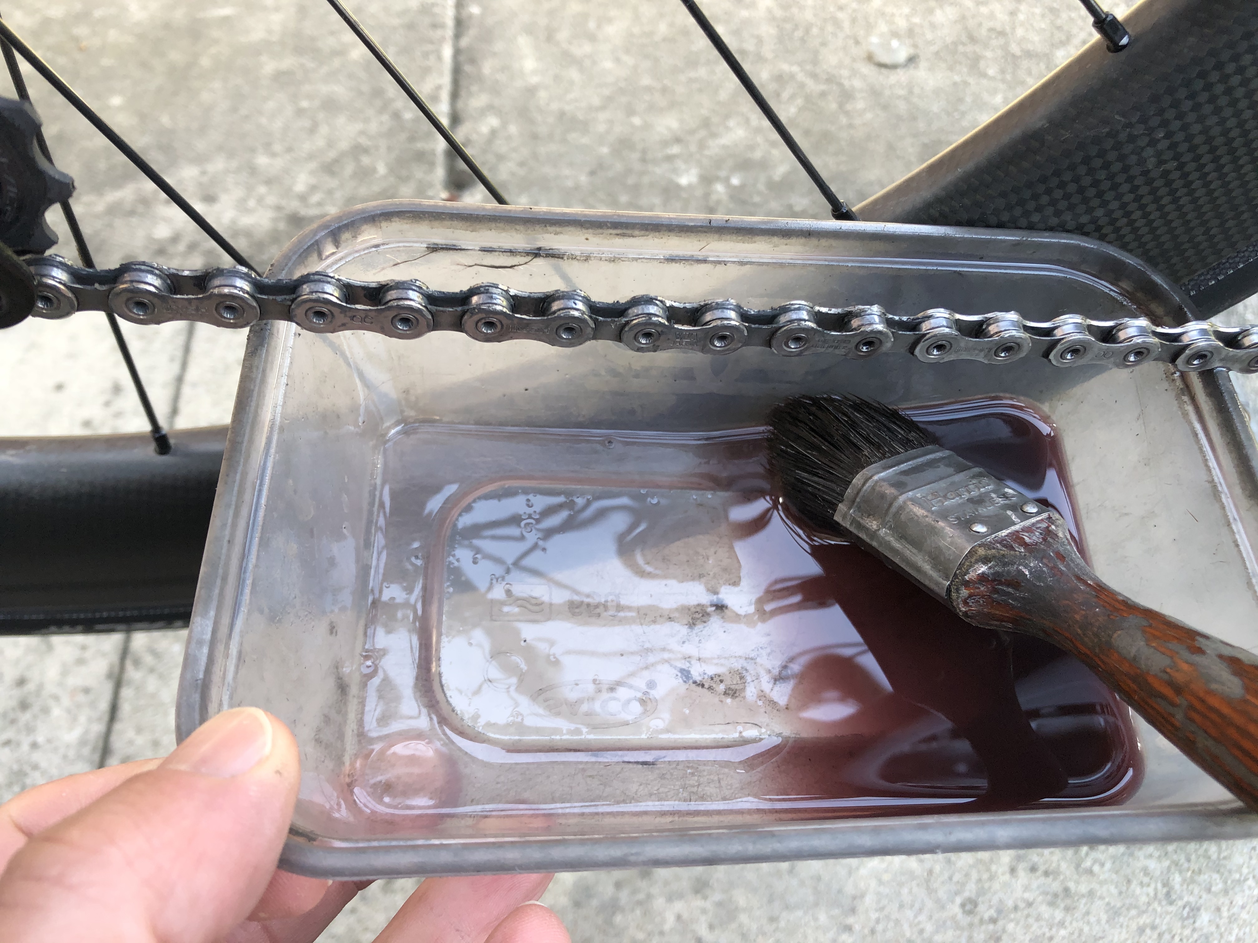

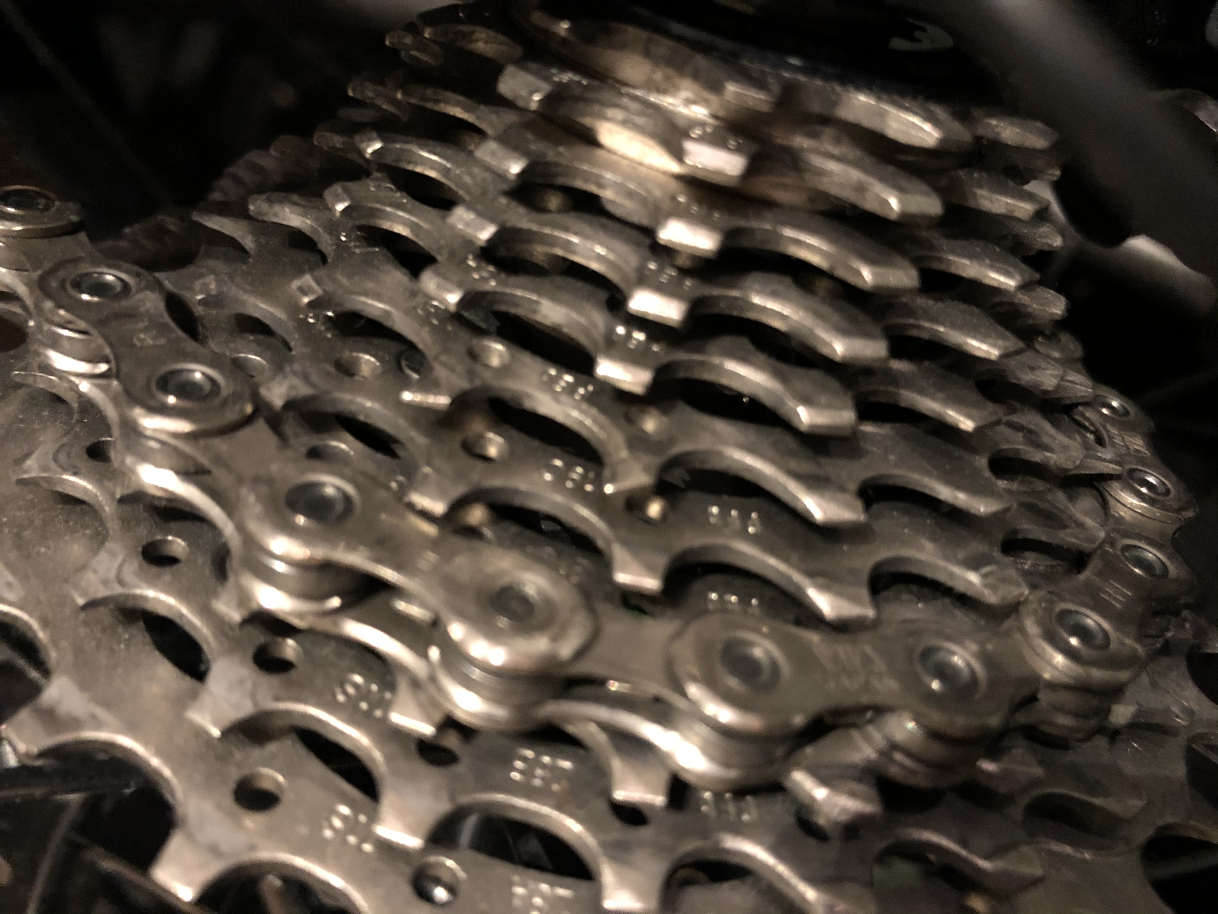

Nothing that can’t be done with degreaser, a take away tub, an old paint brush and 10mins of effort. £8.99 for 5ltr of Screwfix No Nonsense Degreaser, nothing for the tub and the old paintbrush. Has kept my chains and cassettes spotless for years.
Even at £80, thats 45ltrs of degreaser. I find 5ltrs lasts me almost two years. That’s 18 years worth of degreaser for the same cost. Plus, I don’t have to remove the chain (with Shimano quick links you are not supposed to keep breaking and rejoining them), so don’t get filthy and don’t risk the joining link failing, or have to keep buying new ones. And it only takes 10mins.
I looked into ultrasonic cleaners but eventually decided they just weren’t worth the outlay, the faff and weren’t going to get my drivetrain any cleaner than I can with my method.
I instead spent my money on a pet dryer which blows hot air under high pressure and completely dries my bike after washing, including driving all the water out from the pins and links in my chain and around the cassette, which means it can be lubed with dry wax immediately after washing and doesn’t get any rust spots.
Pilot Pete
Here is an ‘after’ picture.
